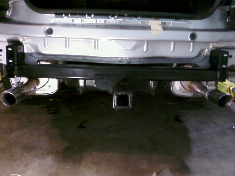

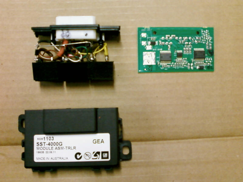

Teaser pics... Fascia is still not installed yet. Been working on the wiring.
Here is the little black box. Original guts on the right. Useless to me. New guts on the left that I built with 3 relays. Not the most pretty thing, but who is going to see it inside the black case? I reused the plug that goes into the trailer harness. And at this point, I only had to cut two wires on the trailer harness and zero wires have been cut on the car itself. Power to the harness is being supplied by the battery junction on the passenger side next to the aux battery area in the trunk. All plug and play.
And here is the towbar installed prior to adding the impact beam. That class 3 receiver looks monstrous, doesn't it?

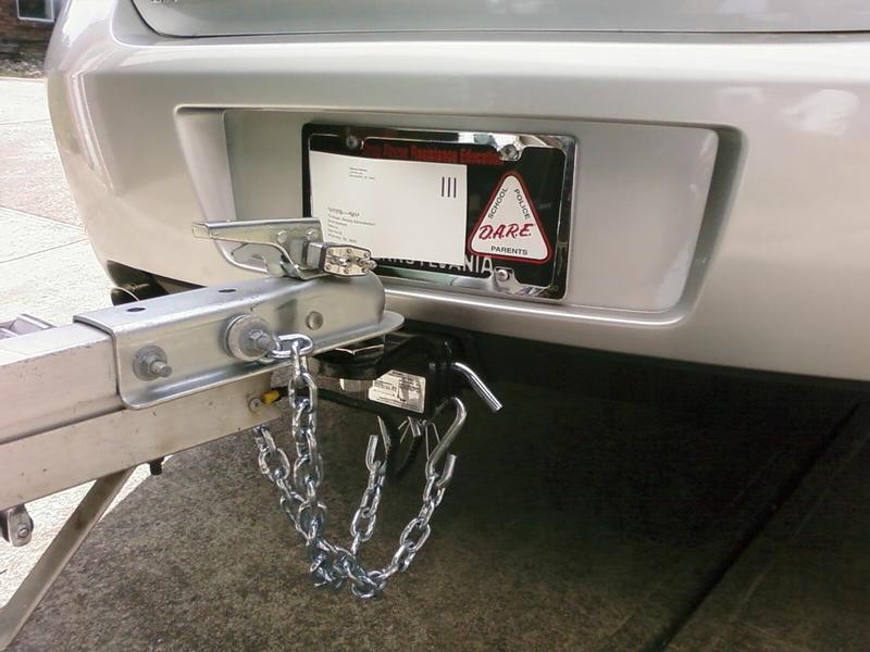

More pics. First one is of the towbar with the impact beam reinstalled. Instead of drilling a hole in the trunk floor as was recommended in the instructions, I was able to route the tow harness out through the rubber plug (on the right) just above the impact beam.
Note in the picture below that the escutcheon around the hole cut in the bumper -- it works. The pin fits fine, even with the escutcheon on these cars (unlike a G8 which apparently is a problem).
The escutcheon didn't fit perfectly though. The top fits tight against the receiver. Kinda needs warped to snap into place. Could have been caused by tolerances from cutting, not sure. I wasn't going to trim it more because there isn't much you can cut before it will be too loose. Not sure the escutcheon (at $50 a pop) is worth it.
I should see if I can get the lower fascia piece (that I had to cut) to keep in stock in case I want to return the car to original condition.
