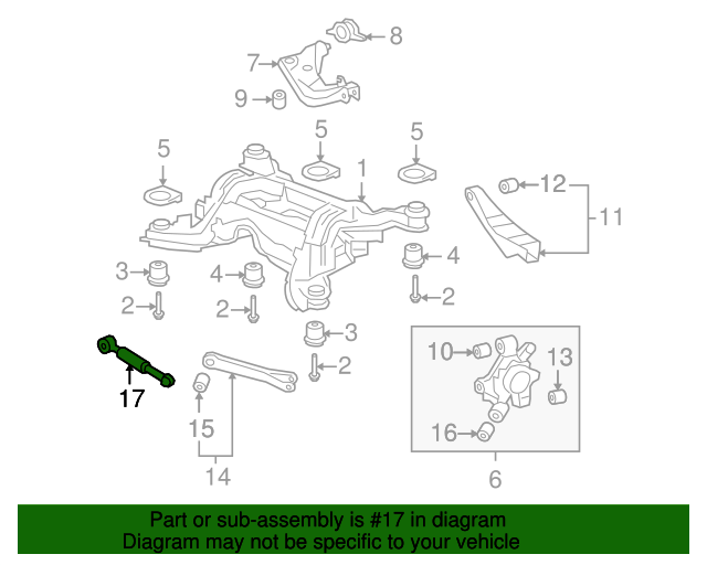

The alignment shops have told me that the rear toe adjustment is "frozen" and it's woefully out of whack (found a local G8 owner that recommended a place for alignment I will be going to since my car just hasn't been right). Does anyone know how the rear toe adjusts? I see that replacement toe-links look WAY different than what the parts diagram on gmpartsdirect.com shows.
vs
Are the bolts eccentric or something? I don't see any threaded sections or locking nuts like one might see on an adjustment aftermarket piece. Only trying to order the correct parts to get the car aligned CORRECTLY. Thanks for the help.

It looks like there is a bolt with an eccentric washer on the inboard end of the adjustment link that is used to adjust the toe-in. It also looks like the bolt can be cut-off and replaced if it is rusted and will not come loose, IF one is still available from GM.

Thank you. When I scrolled down further on the GMPDirect page, there was ANOTHER diagram that had a more similar part to the one I posted a picture of (from ebay). There is no bolt listed there but I'll see what I can find. I know there are rear camber/toe bolt kits from places like Wretched Motorsports that boast greater range of adjustment than stock. If my bolts are trashed, might as well grab them anyhow.

After I posted my reply, I thought about the possibility of the bolt being rusted up in the steel sleeve that is in the bushing, which would keep it from moving. I see you live where you probably see road salt during the winter. May have to cut both ends of the bolt off and spread the chassis apart a little to get the arm out.

The prduction toe link does use an eccentric washer/bolt arrangement.

I used the Camaro links, which have sealed spherical bearings in place of the fixed bushings, offering better articulation, no binding. PN 22875567
