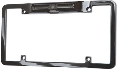

bought mine from amazon (Boyo VTL375 Ultra Slim Zinc Metal Black License Plate Camera) what I liked about this one is that it is a license plate frame with the adjustable camera built in. make for a cleaner install you can see it in the attached pic
Good Luck !

Re: Backup Camera Setup
Can see a closeup here:
That look about right Sardillium? Or did you have the LED lights on there as well?
that's the one

Thanks for the recommendation.....is the video cable supplied compatible with the plug-in on the radio/display in the car? Or do you need a adapter etc. I am getting the White Midification done

the cable will not directly plug in to the radio you need to make your own adaptor you can contact Tom Slick on this forum, he sells a kit to make the connector you need
