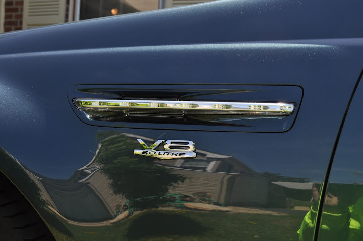

I'm having a heck of a time trying to figure out which wire(color) goes to the corner turn signal light in the headlight housing.
I assume it's one of the wires in the headlight housing connector.
I ran a wire from the side marker/repeaters to the headlight so I could hook them up to the turn signals.

bkwagonss wrote:I'm having a heck of a time trying to figure out which wire(color) goes to the corner turn signal light in the headlight housing.
If it's the same as a Holden WM Caprice Series1 (???????????) then at the 10 Cavity Connector for each Headlamp.
Left Headlamp, Left Front Turn Signal Supply Voltage = Pin 9 = Light Blue Wire with a White Trace.
Right Headlamp, Right Front Turn Signal Supply Voltage = Pin 9 = Dark Blue Wire with a White Trace.

The top and bottom horizontal surfaces are chrome from factory. The outer bezel is plain white plastic = requires painting to suit car body.

I can do a pair of the Holden Caprice side indicator (repeaters) complete with a pair of wiring connectors for US$333 total shipped.
Airfreight ETA is 14 days.
My Paypal ID is
pjsadler@iinet.net.au
E-mail address is also
The wiring connectors are approx 6" long and plug into the odd shaped connectors on the inside of the repeaters. You can then run new wiring back to within 6" from the repeater and make your new wiring connection on each side of the car.
