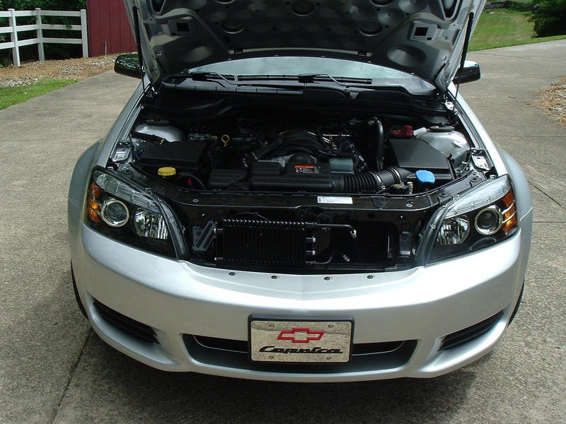

wheres your oil cooler radiator?

PostPosted: Tue Mar 31, 2015 11:41 pm
Offline
Joined: Mon Aug 11, 2014 5:27 am
Posts: 39
Location: Arizona
I think what xcidmigs is talking about it the missing cooler in front of the radiator. If you notice all the cars except the one in the first picture have an auxiliary cooler (for tranny or Power steering) behind the grille in front of the radiator. The cooler is not present on the black car.

PostPosted: Wed Apr 01, 2015 2:24 am
Offline
Joined: Wed Jan 21, 2015 3:29 am
Posts: 284
Location: Katy, Tx
Mine is also a 2012. You can see the mounting and cooler lines for the trans cooler on the driver's side of the black car. Mine is the same as his. The power steering cooler runs under the a/c condenser, the full length of the condenser.
See page 15 of the 2012 guide and compare it to the 2011 guide.
http://www.newcaprice.com/files/2012_Po ... Manual.pdf
http://www.newcaprice.com/files/2011-Ch ... Manual.pdf
